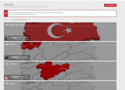

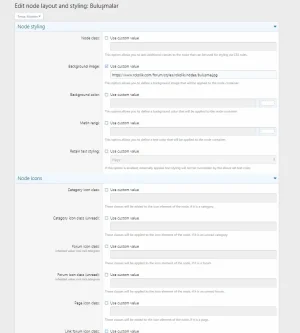

When applying a background image to a parent node, is there a way to prevent the image from also automatically being applied to all child/sub nodes?
Did you make background image changes through the Default layout and styling section of Node layout and styling? If so, there is no way to keep those images from showing within child/sub nodes.
Now if you went ahead and made changes on a per theme basis then you wouldn't have to worry about them showing then. So just choose a theme from the drop-down (screenshot 1) and change the background image for each forum that isn't child/sub based(screenshot2).

No, it doesn't matter what individual style I choose. If I set a background image to a parent node, all that node's subnodes show the same background - in that style only, to be clear, not all styles. Granted, I can apply a different background image to each subnode, but until I do each will show the parent node's background by default. If this isn't something you can reproduce on your end, then I suppose I can only assume it's a conflict with another addon (although I have no errors) or a bug with my version. I'm still using an old version: 1.0.7 Patch Level 1.

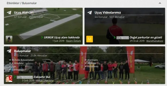

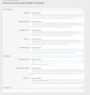

I guess after the last upgrade of UIX- 2 to 2.1.10.0.0 , for FORUMs NODE GRID feature is missing ?? "Category" has still NODE GRID feature.
How can I use NODE GRID for "forum" ?
Category NODE Grid:
Forum does not have NODE Grid anymore ?
Because of that reasons, all sub-forums are listed like that :(
I want to have them as side by side as it was before like this:
Category NODE Grid:

I am not able to replicate what you are as I tested both 1.0.7, 1.0.7 PL1, and 1.0.7 PL2 for what you mentioned above. I was never able to replicate the node grid section when editing each node. If you'd like to change the node grid then navigate to Forums -> Node layout and styling -> Default layout and styling. Although I may be missing something please let me know :)
Very strange.
I can remember what "Default layout and styling" is doing? I always configure "Category" and "forums" as I show at above.
I have demo site with same problem. So may be it will be better that I can open a ticket and you can check yourself @Dalton Prock
