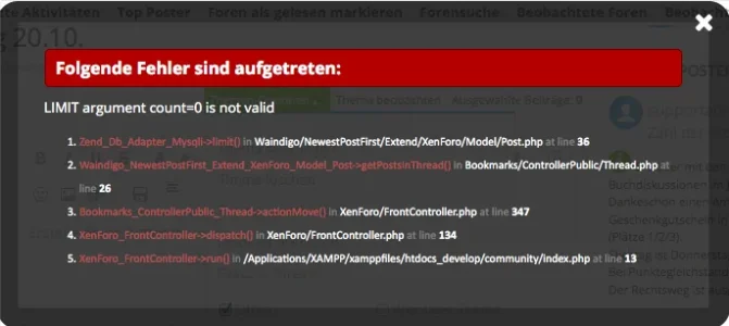

This is fixed in the next release of Bookmarks.I use this addon since several weeks and my users love it. However, today a problem occured when I tried to move a thread from one forum to another.
It seems as if this addon collides with the bokmark addon. It is interesting to see that everything works fine as soon as I disable "newest post" or "bookmarks". However I would like to use both.
What can I do @Jon W @Daniel Hood
