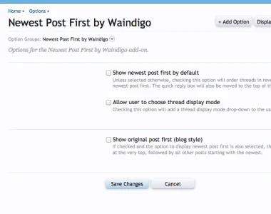

When this addon is installed and active, it keeps the post reply box at the top of the site even when you don't have posts reversed. Also, is it possible to add an option to turn off moving the post reply box? The way it is now is not where it's at in vBulettin or even some asp forums.
http://www.8thos.com/threads/everyone-post-here-testing-something.19932/
I checked the second box, then changed the settings in my preferences and I get the same results as above.
The only time it actually reverses the posts is when I check the "newest posts first box" in AdminCP options as default.
Are you sure? I can't replicate this.
