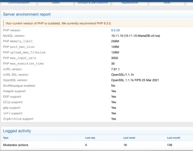

My hosting company is saying Snuffleupagus package is for PHP 7, not 8, and can't be installed on my shared server plan.
my admin panel is reporting "no" for Snuffleupagus.
Can anyone tell me what this package is and why i might need it for Xenforo?
Snuffleupagus is not actually a requirement. In actual fact, it’s usually better if it’s off. The server environment report is for support and troubleshooting purposes. This entry is there because sometimes if it’s enabled and not configured correctly, it will cause problems.
So the recommendation is to keep it disabled.
Thanks for fast responses. Glad to know i shouldn't need it.
Can't recall why i had it enabled on my previous host... possibly there are some add-ons that needed it?
Thanks! Are Exif, Gmp, Intl packages necessary or helpful? They were also installed at my previous host but were defaulted off at my new hosting company before I had them turned on since that AdminCP area was reporting them as "NO" status.
EXIF information is essentially metadata and embedded in the image.
gmp support is required for push notifications.
INTL provides more robust handling for removing accents and romanizing strings. This is likely of greater importance for non-English users
