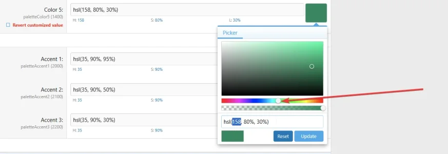

No global setting for the main style of the forums. It's easy enough though, open the color palette and adjust color palette 5. Use only the color slider, don't move the dot above:

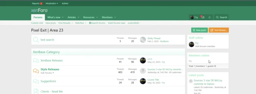

Then when you find a color you like, copy the first number (in the screenshot above it's 158). This is the "hue".
Then go to colors 1-4 and paste the value in the same spot. It will create a similar version of the default style just with your preferred look:
Fine tune here, then go to the basic colors to adjust further.
