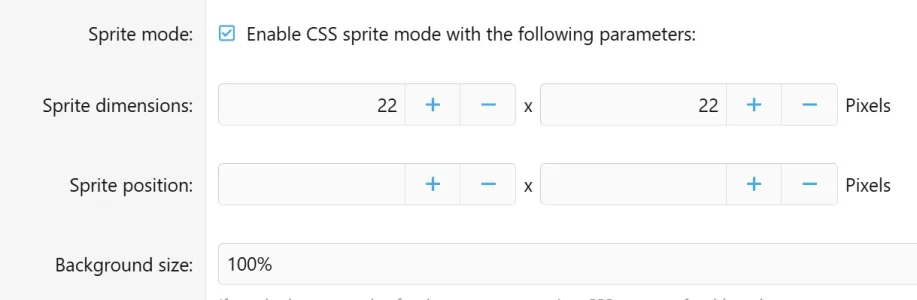

You shouldn't need to mess with adding anything to your extra.less file; instead turn on the checkbox for "Sprite Mode", set your dimensions there to be 22x22, and use 100% for the background size.

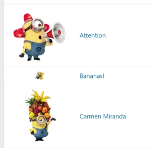

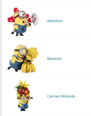

To see that in action, below are three screen shots. The first screen shot shows some Minions with the sprite mode turned off, then a screenshot showing the settings updated to turn on sprite mode (with dimensions & background size), and then the result.

Large Smilies with Sprite Mode turned off
Update the "Bananas!" smiley to turn on Sprite Mode, specify 22 x 22 for it's display size, and use set the background to be 100%
Here's the same "Bananas!" smiley after changing the options above
