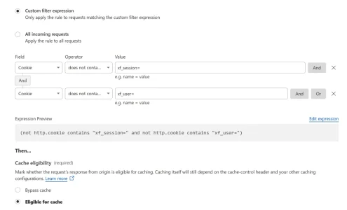

Your CF pages for guest users are still showing "DYNAMIC" meaning its not being cached. Cached = HIT.
Make sure you got the rules setup as per digitalpoints settings/faq on that topic. To check, be private tab, use dev tools > network > pvpers.gg (on left) > headers ..
Check my site:
hit = cached.
Check my site:
hit = cached.

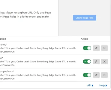

Thank you I provide my controls for the installation.

By the way, my native language is not English. Is there an explanation on how to make this HIT setting? I couldn't find it.
