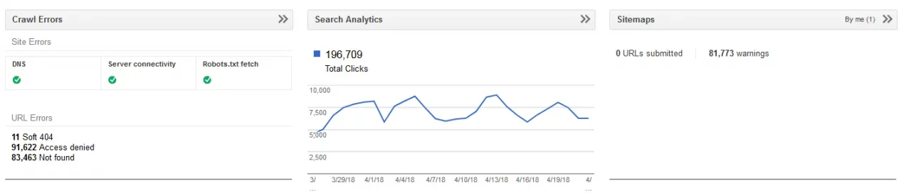

Since two months age I have faced with a strange problem that I couldn't find the exact solution. it drops amount of visitors significantly.
As you know google has introduced its new search console since months ago, it the performance section of this console it shows amount of excluded URL which in my case is more than 950K and the most of them are "Page with redirect". There are tons of URLs like this http://forum.mydomain/posts/4395811/
The other problem is sitemap. in new search console the status of sitemap is "success", but it doesn't show any discovered URL and the number of URLs which has discovered is 0!
When i'm checking google webmasters dashboard in section crawl/sitemap the status is pending with more than 80K warnings.
it says:
Url blocked by robots.txt.
Sitemap contains urls which are blocked by robots.txt.
but I dont block anything.

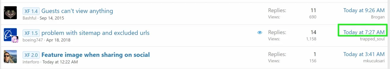

Hi,
Unfortunately, you cannot fix this issue in XF 1.5. But it's not a harmful issue, because when Google follows the link it redirects correctly via 301 header.
Those links are from the front page (latest post for a topic) and also for thread/topic list inside a forum. Example:
In XF 1.5.x the link is "forum.mydomain.com/posts/1141376/". You click on it and it will 301 redirect to post permalink, e.g. https://xenforo.com/community/threads/problem-with-sitemap-and-excluded-urls.146077/#post-1249074
In XF 2.0 they changed this. They included full topic URL and appended /latest/ at end. e.g. https://xenforo.com/community/threads/problem-with-sitemap-and-excluded-urls.146077/latest , then when you click on it, it redirects to post permalink: https://xenforo.com/community/threads/problem-with-sitemap-and-excluded-urls.146077/#post-1249074
Also, in XF 2.0 they added "rel=nofollow" for these links:
<a href="/community/threads/problem-with-sitemap-and-excluded-urls.146077/latest" rel="nofollow">Today at 7:27 AM</a>
You have to understand, the new Google Search Console is very sensitive and tries to be helpful by reporting these warnings. It should be OK to ignore, but yes it will be annoying..
I think in XF 2.0 this should not be an issue now, but I am not using XF at the moment to 100% confirm.
