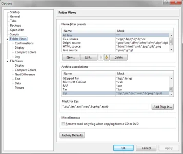

On my test server I use PHP with imagick (v6.6.0, not the latest I know). While doing some tests with xF, I stumbled over this PNG file that made my PHP-FPM processes crash (SIGABRT). I never had this happen with GD, but since imagick is supposed to generate superior tumbnails, I thought to give it a try...
Could you try attached PNG and see if it works for you if you use imagick? I may upgrade the test server to run a later version of imagick, but for now I am a bit taken aback how one PNG could crash the whole PHP process.

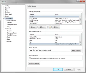

Tried on my Nginx and PHP 5.4 PHP-FPM server with and ImagicK and your image failed. It's the image that is problem. I did a screen capture copy of image and named it failure_new.png and that processed fine in Xenforo
using ImagicK 3.1.0RC2 php extension and ImagicK 6.5.4.7-6.el6_2

Thanks for testing. Yes, it's the image that is crashing imagick, but it really shouldn't do that. Anyone could upload that image and (maliciously) start crashing someone's PHP processes.
I have been using GD for over ten years, and never did I encounter something like this. It shouldn't crash. If it doesn't like the PNG for whatever reason (GD is OK with it, various image viewers I tried are OK with it), it should send a failure return code. I am too lazy to compile imagick and its PHP extension with debug symbols, but I was still interested if this apparent bug had been fixed in later versions.
It's too bad. Despite imagick being said to produce superior thumbnail results, I will most likely go back to GD.
