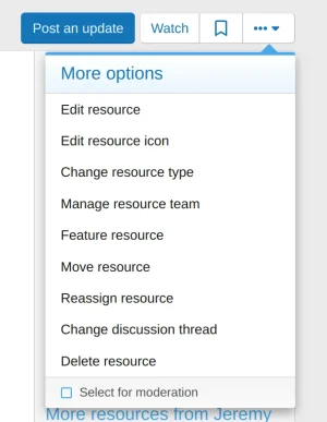

Oh, yes the support URL serves a different purpose. For this, you should use the 'Change discussion thread' tool in the drop-down menu. It will do what you want.

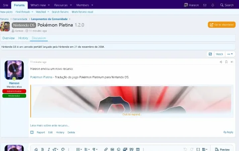

Adding more information, the image below shows a topic created automatically when submitting a new resource. Note that, although we are viewing the topic, it is linked to the resource, so you can download it directly or even browse through the other tabs.

This should already be the case. I can't reproduce this locally either, using the 'Change discussion thread' tool to an existing thread causes the resource header and tabs to appear on top of the thread.
So it is. I asked a member of my forum to repost his Resource. I deleted the topic he had created, and then with the new Resource he posted, the automatic topic came.
The automatic topic (which is defined in the settings) is integrated normally.
Solution
Oh! Thanks, Jeremy. I hadn't really seen that option there. I was always editing the Resource and there was only that option.
Thanks for the clarification, now I won't need to recreate topics for this. Thank you very much!
