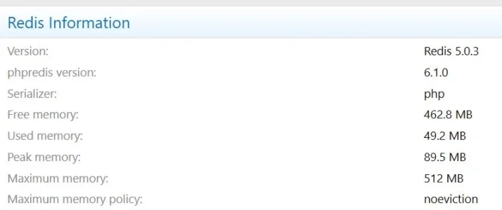

? This is very new to me. Edit which config?View attachment 314760

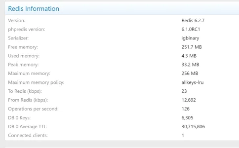

I never use a lot of memory on mine. You'll want to use; allkeys-lru to act like memcached. Also use igbinary serializer as its considered faster.
Examples please.redis.conf
Ah wait, this is Xen configExamples please.
#Redis
$config['cache']['enabled'] = true;
$config['cache']['sessions'] = true;
$config['cache']['provider'] = 'SV\RedisCache\Redis';
$config['cache']['config'] = [
'host' => '127.0.0.1',
'port' => 6379,
'compress_data' => 6,
'serializer' => 'igbinary',
'password' => 'x'
maxmemory 256mb
maxmemory-policy allkeys-lru
