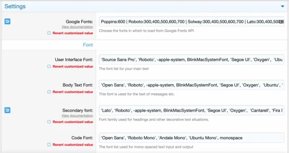

This is the backend setup as it normallyScreenshot 2020-01-12 at 22.32.36.webp is:
I'm almost certain that there aren't supposed to be spaces between the pipe symbols in the Google Fonts field... if you remove the spaces does it make a difference?
