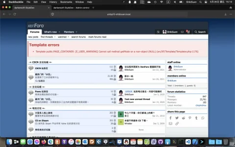

I just upgraded the CSCN-Anniversary style for XF 2.2.13 (on XF official demo site), and I found that the upgraded version is no longer programmatically compatible to earlier releases of XenForo 2.2.x. For example: 2.2.8, see the screenshot below.

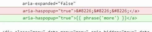

I checked out your style and I think there is a balance in the edits you should include. Things like this in your post_macros template is the only edit:
To me, this isn't an edit I'd make on a style releasing to the public. If an end-user wants to do that, an edit in the child style would be best. The message_macros templates sort of the same thing. The only edit you have is a container wrapped around the user banners which I don't really think that's necessary. I mention these two specifically because they were technically the "hardest" to update.

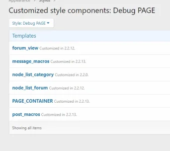

One thing that helps me out a ton is I have a "Debug" style which has a simple edit in each template our framework modifies.
In those templates I have a single line at the top edited:
This will make it so these templates are outdated if XenForo updates them and I can easily see which code has been modified. This is way easier to read versus having my custom code in the compare screen.
There is a reason why I ditched these 3 dots: They can cause y-axis aligning problems with the triangle symbol (for certain fonts only), if my memory is correct.
I am afraid that one "…" should be enough.

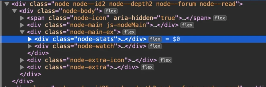

The forumbit (the node list in the forum homepage, watched forums, etc.) does have structural changes: I need a unique container to manage both "stats" and "watch":
Is this also achievable using LESS?
