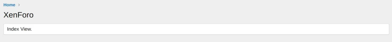

Given the above explanation, I thought I'd reference actionIndex() for account/notes?

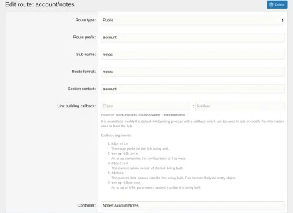

Ensure your route format matches the sub-name. Using your code (with a fixed namespace) and the following route configuration and browsing to account/notes:
When setting a sub-name, the route format needs to be set to match. I had overlooked that detail in your previous message.

That would be because the format has a + in front of the note_id parameter, which means the note_id must be present for the route to match. If you remove the + then the note_id is optional.

Thank you!!! I really really really appreciate all the help! I think I finally got a handle on this now.
No worries, a lot of this stuff should be properly documented to avoid the headaches. Glad you got it working.
