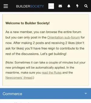

But how can I show a notice to these new members telling them that they need at least X or Y to post in this specific forum?
What has happened in my forum is, that the button for new posts has simply disappeared.
How can I set up such notifications, as in this example?
