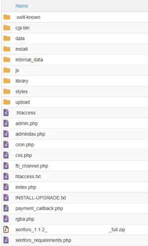

I haven't used this license in some time and wanted to see if I can move my vB forum to 1.1.2 before upgrading.
It's been a long time since I've installed a xF forum. Never had an issue before so I suspect it's somethin on the server side.
I want to be sure structure is correct first, Files are in my public_html directory.
I have not created a database yet. From what I recall, I will be prompted for that information to create a config file. I'll create the database at that time.
I see nothing in the error log.
