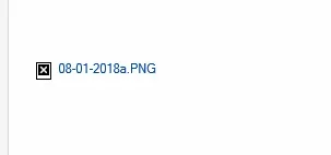

IE11 is unable to display attachment thumbnails in posts, instead displaying the alt image text:
Instead of the correctly loading:

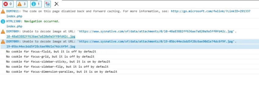

What does the browser console show? It should reflect an error stack trace in it for the image.
OK.. have found some relevant Google searches and most have to do with Mime types in the Apache configuration.
Some have been due to the image not really being the type that the extension says it is (a PNG shown as a JPG as an example).

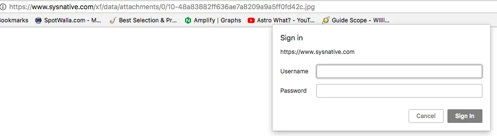

I can't really tell as curl -I is giving me a 401 error (unauthorized) which indicates that direct linking to the image is not allowed or I typed the URL in wrong.
It may also have something to do with this, which would give me a 401 error that I'm getting.
Is there a particular reason you have your /xf/data under htaccess type protection?
This would probably work fine as long as your server IP is in there... but it does present a problem for trying to troubleshoot the image since I can't access it to check the mime type that gets sent.

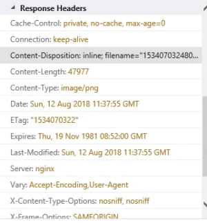

The image is password protected as it's on a dev forum - but here is the IE11 headers for the image itself:
The image loads fine when following the source URL. Not working at all in the posts for IE11.
Could try disabling nosniff on x-content-type-options, but I'd rather resolve the root issue instead of removing a security measure.
If you notice, it's shown to be a JPG in the link, but your Mime type (Content-Type) is actually a PNG. This is an IE 11 issue, and removing the nosniff content type header will allow it to work. The only problem with that is it goes against good security procedures. You could change extension of the file and re-upload it to that message as an administrator and then delete the link to the old one. I would NOT rename the file in that directory though as it may be listed in the DB also.
