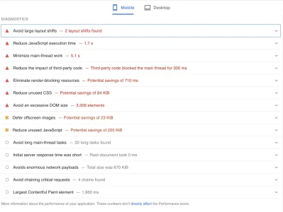

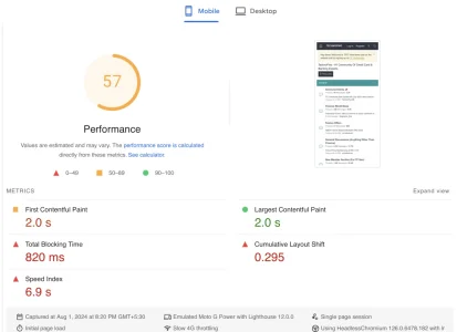

Themes, add ons, google ads, images, css, fonts, .... however impact the website performance. Can you share the link to your PSI?
Mobile yes, desktop is a lot better.
I think it has to do with the advertisements you're rendering. They are known to slow down websites. Disable them, run the report again.
You seem to be loading Material Icons as well, even though as far as I can tell none are actually used. It may be worth removing that, and swapping any usages to Font Awesome icons instead. It may also be worth lazy-loading ad images, but that might be up to the add-on you use.
For what it's worth I'm getting a mobile performance score of 86 on your site with an ad blocker enabled.
