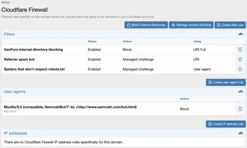

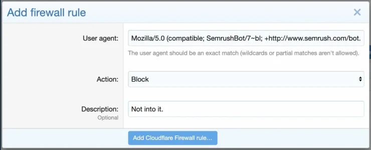

If your site uses Cloudflare (the site in your signature does), you can block the request at the network edge before it even gets to your server with Cloudflare.
Cloudflare allows you to block requests based on user agent.
You can also manage Cloudflare firewall rules without leaving the XenForo admin (if you want):

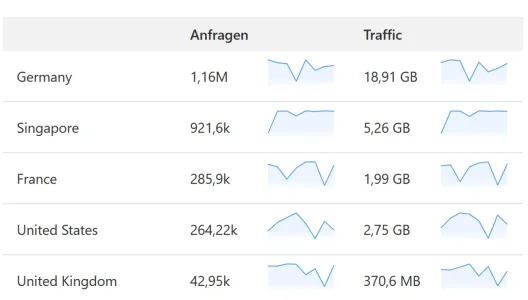

How can I see which Bots/IPs are accessing from Singapore and what is the easiest way to block them completely?
I suspect "Bytedance/Bytespyder".

That wasn't your question... your question was, "How can I see which Bots/IPs are accessing from Singapore".
...and looking at your web logs is the correct answer.

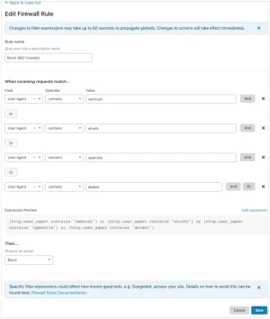

For blocking ahrefs, I just applied tonight, I'll see how it does. You can keep adding more as needed but the 2 biggest offenders imho are ahrefs & semrush.
Select your domain, then security, then waf. Add a custom rule as shown below. I suppose for some like the guy above, cloudflare can be a bit tricky sometimes so for such people, there you go.
