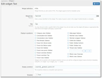

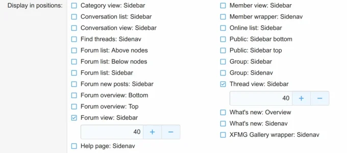

Just tried it, works fine for me with "Thread view: Sidebar" as position.
I tested and created New Threads Widget: /admin.php?widgets/add&definition_id=new_threads
Place it on: Thread view: Sidebar
With Display Condition: count($__globals.posts) > 4
Not working though :/.
What would be the right condition?
Thanks!
