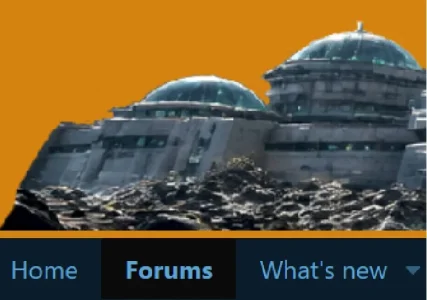

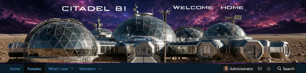

For visual appeal, I am using a graphic image as my logo. The problem I would like to solve is how to make the logo image align with the bottom edge of the header so it appears directly above the nav bar with no padding.
Here is an example I created with an extremely contrasting header background to illustrate the problem.
It is the area under the logo image that I am trying to eliminate. I don't see any padding settings and nothing I've tried with the image itself has made any difference. This is limiting my creativity.

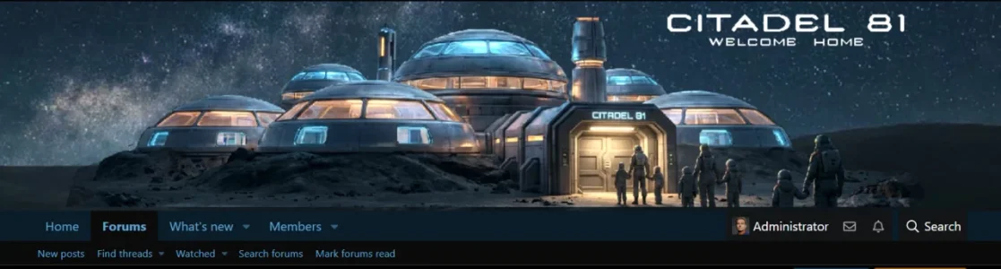

It is not so bad with a dark background like with the header image I'm using now but it is still noticeable if you look closely as you can see on my current header/logo here:
Any idea to fix this would be appreciated. Thanks in advance.

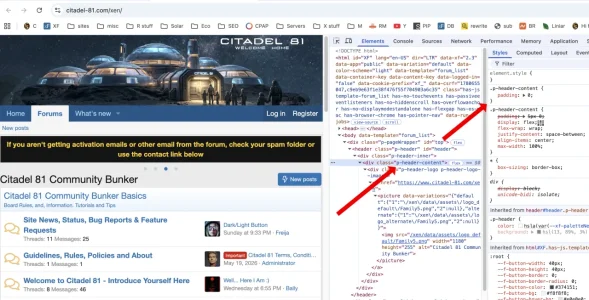

Looks like it's p-header-content padding
Try in the extra.less template adding
CSS:
.p-header-content
{padding:0}
Edit it may need a priority:
CSS:
.p-header-content
{padding:0!important}
But try without first
CSS:
.p-header-content
{padding:0}

Solution
@Mr Lucky
You, sir, are a genius! This absolutely 100% fixed the issue and I am so happy. Thank you a ton! This is the 2nd time you've come to my rescue.
It worked without the important needed although having this work like I want is very important to me! :D

Under style properties>basic options, have you defined the public logo width and public logo height sizes? You can also change the background area of the logo by going to style properties>Header and Navigation>Header/logo row and changing the color or adding an image.

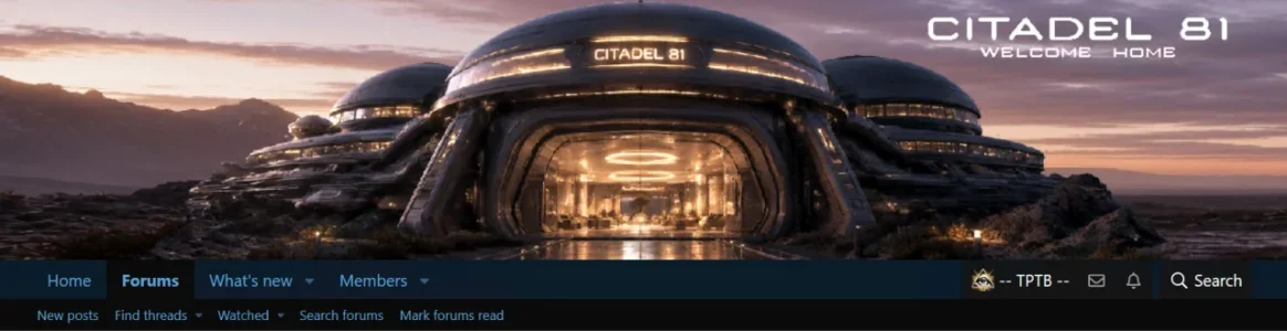

To get the look I want I'm using both a png with a transparent background for logo and a jpg header logo row image because I'm using rotating logo images with different background images for the header/logo row. I have defined my logo width and height sizes as 1180 x 255. The images used for the header row are about 2200 x 260 depending on how they wrap when zooming in and out. It makes a neat effect with the logo image staying fixed and the background resizing depending on zoom level. ( https://citadel-81.com/xen )
My problem was padding under the bottom of the logo image preventing it from sitting exactly at the bottom of the logo row. The entry in the extra.less template provided by @Mr Lucky fixed my issue.

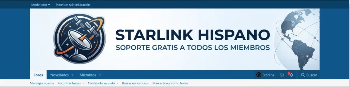

@Elisabeth_K It fit you well, unlike I do not like to use the black background ... I prefer the default style the other option could be to use the same image as the original xF logo but with reference to my site. My preference is to use old banners but I do not consider myself a professional to achieve it

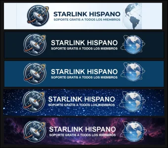

You have a lot of possibilities. I couldn't find the globe image you used but knocked out some quick samples to give you ideas.. The bottom two use an image for the header/logo row background.

Tienes muchas posibilidades. No pude encontrar la imagen del globo terráqueo que utilizaste, pero preparé unas muestras rápidas para darte algunas ideas. Las dos de abajo utilizan una imagen como fondo para la fila del encabezado o logotipo.
