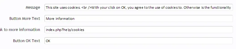

2) in the option add <br> to linebreak (see attachment)

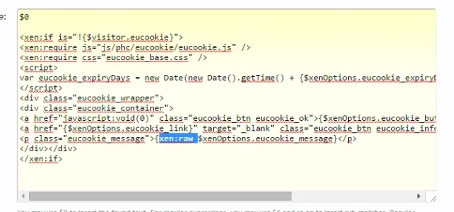

3) Template Modifications -> [by xen-Hilfe.de] EUCookie -> Edit footer - and add "xen: raw" see attachment

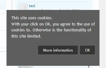

result (after "this site uses cookies." is a linkebreak)

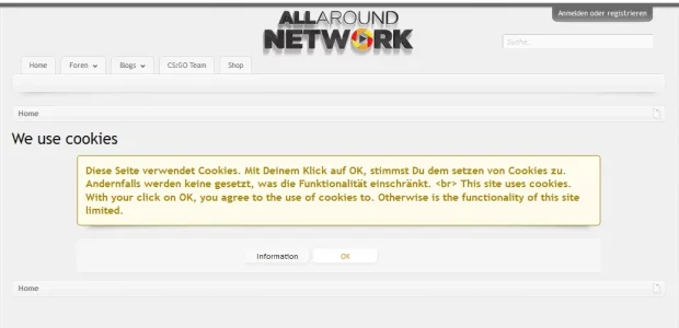

HI as u described above i added the line break function to my Website and it works lie a charm :D
but i noticed that it doesn't work when its not a popup as u can see in my attached Screenshot.
How can i fix that?
PS: is it possible to center the text (with BB or HTML code?)
