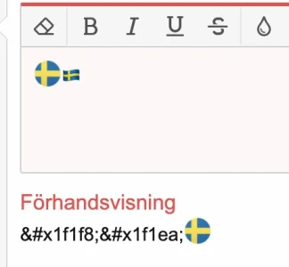

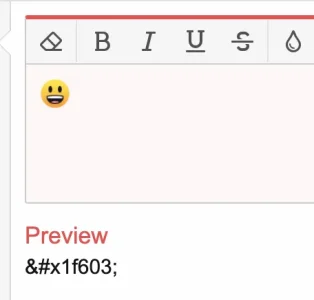

Example on how it looks. The second example is the Swedish flag added from editor, and then from my keyboard.

Thanks. But after more test, it turns out the problem is with the emoijis, not the smilies - smiles work fine, but emojis entered using editor are shown as &#... I have edited the thread title to reflect this.

But I then changed the collation to utf8mb4_swedish_ci though, as I want that instead of the general_ci that is hardcoded into XenForo - to get proper sorting and searching for Swedish. (Unfortunately I did not check emoji support before changing).
As emojis are shown when entered from my keyboard, (both OSX and my iPhone) but not when added from editor, it seems the collation is fine - it can actually store emojis.
So to me the problem seems more related to the editor, something is "turning off" emoji support, showing hex character entity syntax instead. Maybe it thinks there is no full unicode support because I changed the collation to utf8mb4_swedish_ci?
I have looked for code in XF to see if there was a check "if utf8mb4_general_ci show emoji, else show &&#..." or something but not found any.,
