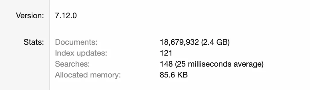

hi,
if we install elasticsearch on our server to use it with XF enhanced search - which version should we use?
I have seen that it must be at least 2.0
...and that some people not happy with 7.11
so.. wich one should i use?
thank you !
There are so many version 7.x before the 8.x but i see it's better to install version 7, but which version 7? Any version ?
thank you
