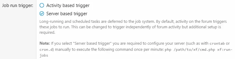

2) if you want more control and to disassociate cron tasks with user activity, change the "Job run trigger" option to "Server based trigger" and use a server cron task (ie crontab or cron.d on unix systems):
