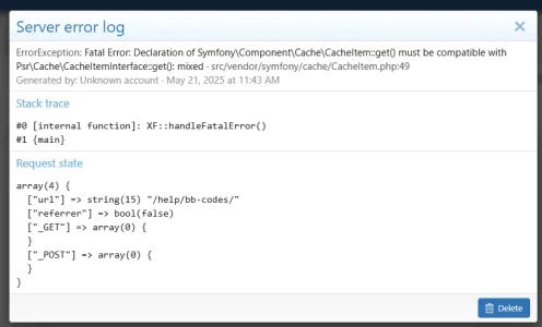

Hey @Jeremy P & @robdog ,
I get following error, when I try to open: https://www.mydomain.com/help/bb-codes/
I am using XF v2.3.6 and [MMO] Hide Bb-Code Content System 2.3.4.
I am hosting the Website wih Plesk and the Website is behind Cloudflare.
I try already PHP 8.1.x - 8.4.x but allways the same issue. The addon developer says it's not releated to the addon.

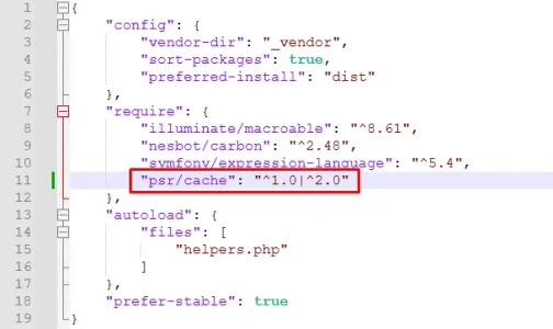

I have also tried with adding
under:
/var/www/vhosts/worldofiptv.com/httpdocs/src/addons/MMO/CoreLib/composer.json
and run:
Bash:
root@srv:/var/www/vhosts/mydomain.com/httpdocs/src/addons/MMO/CoreLib# composer update

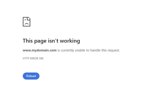

but I still get the issue. I don't know what I did wrong and how to fix it.
I'm really desperate, so I would be very grateful for some help.
You're depending (transitively) on symfony/cache 6.4 but we ship and expect 5.4. You can run composer depends --tree symfony/cache to see why.
