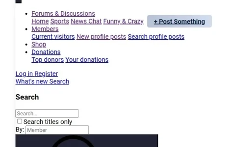

I THINK my CSS file is doing a disappearing act on me a few times per day.
The forum will randomly stop displaying the style correctly. Sometimes works, sometimes doesn't. We can't figure out what would cause this.

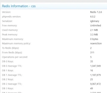

Also, it's likely a cache issue. are you running something like redis?
when it happens, pop open the f12 toolbar and look at the network tab. it should show some sort of error for the css files.
see what code it's throwing.
Redis is more query cache, his issue is likely local cache.
I'm having the exact same issue as reported by some of my users. Only a few specific Cloudflare POPs appear to be affected. I was able to confirm it by using a VPN to affected users' area.
Specifically, only CSS delivered via XenForo's css.php files are broken (other custom CSS files served by my site, including those on my XenForo pages, are not affected).
Closer inspection shows files which should look like this:
CSS:
@charset "UTF-8";
/********* public:normalize.css ********/
/*! normalize.css v7.0.0 | MIT License | github.com/necolas/normalize.css */
button,hr,input{overflow:visible}...
Are prematurely truncated to only the first line:
CSS:
@charset "UTF-8";
Clearing the cache for these files does nothing, nor does disabling caching on these files, as confirmed by the presence of cf-cache-status: DYNAMIC in the response headers.
