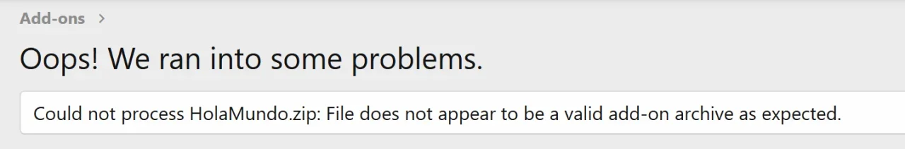

I have created this basic addon to test but when I upload it to the src/Addons folder, I can't see it in CPA to install it, and I have given 777 permission to all the folders.
Please could someone check the addon to see if there is something wrong.
Thx in advance.

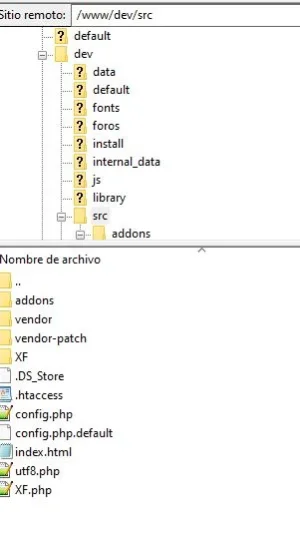

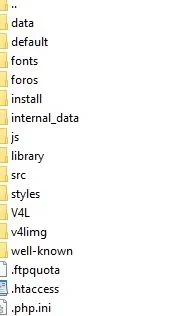

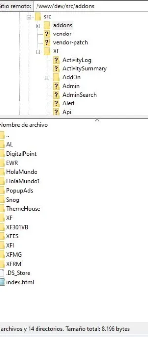

How does the directory look like?
I usually don’t download zip files from sketchy sources, lol. But you’re free to provide a screenshot.
Also 1.7kb seems very tiny to be an addon.

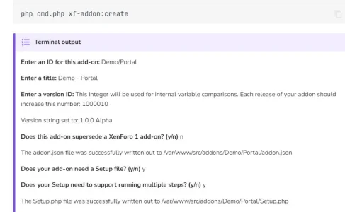

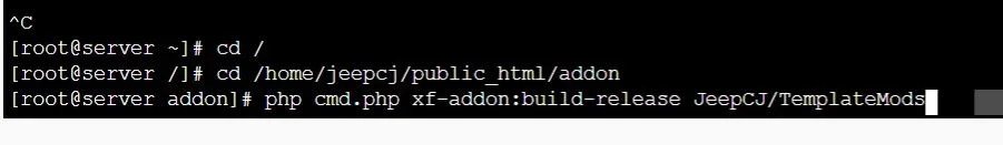

In XF root / install
php cmd.php xf-addon:build-release Demo/Portal (Demo/ Portlal) should be ???directory???/ HolaMundo
Example:

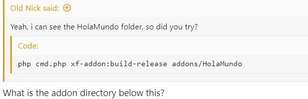

Yeah, i can see the HolaMundo folder, so did you try?
php cmd.php xf-addon:build-release addons/HolaMundo
I tried but I get the saem error.
volvo4life@vl27187:~/www/dev$ php cmd.php xf-addon:build-release src/addons/HolaMundo
No add-on with ID 'src/addons/HolaMundo' could be found.
