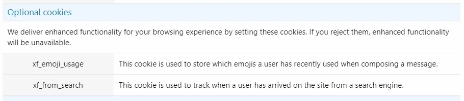

But how is that different from XenForo remembering the last used smilies / emojis?
The cookie used for this (xf_emoji_usage) is (by their own definition) classified as "Optional".
XenForo describes optional cookies as
We deliver enhanced functionality for your browsing experience by setting these cookies. If you reject them, enhanced functionality will be unavailable.
To me, this perfectly fits for xf_toggle (and a few otehrs as well) - it enhances the browsing experience by remembering the toggle state of controls.
Without this cookie, the user could still toggle an element (like collapse a category) on a page, but this would not be remebered.
To me, this perfectly fits for xf_toggle - it enhances the browsing experience by remembering the toggle state of controls.
Honestly, I feel like the one (but not the other) cookie being - by XF's own definition - classified as essential vs. optional is so they do have cookies that can be declined. Sure, you could make an argument that it's not the case - but it's also not that hard to argue that even the emoji cookie is sort of essential (if you use the emoji picker).
