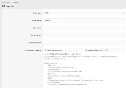

Before that, is something like this in Development/Routes possible if you knew the exact params for that URL (if there's a way to capture them) as they should be unique?
No, the router doesn't work like that. The link building callback is only for doing manual processing when creating link strings (ie. in templates) and is separate from routing itself.
