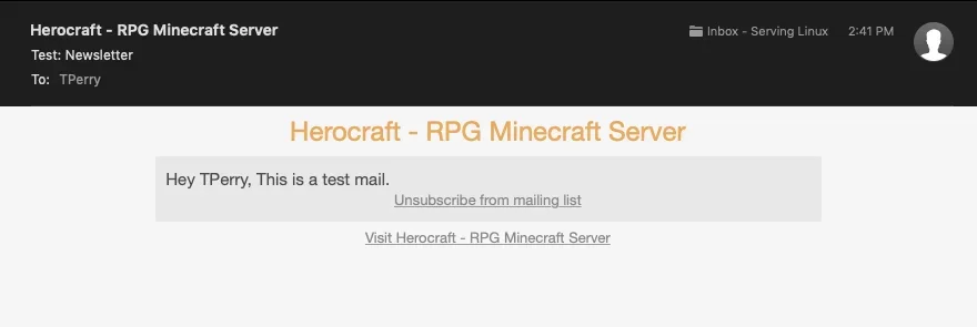

Try sending a message to user TPerry (I just signed up expecting to get email confirmation but didn't) from your ACP and we can see if it goes through. That will go to an email server hosted by myself.

And it came in just fine.
My mail system has a greylisting ability and you didn't hit it nor any of the major blacklists - so it looks like it's mail server specific.
