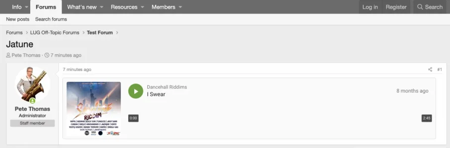

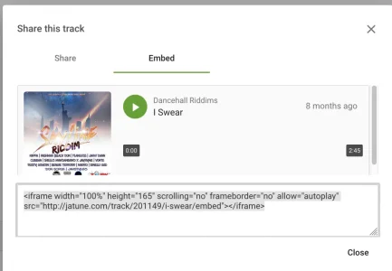

It looks to me like the actual embed code given on your site does not actually work.
This track for example:
<iframe width="100%" height="165" scrolling="no" frameborder="no" allow="autoplay" src="http://jatune.com/track/201149/i-swear/embed"></iframe>
If the actual embed code given for each track worked, it can't be that difficult to create a media bbcode

Yes - if that link above is playing correctly.
It seemed tricky at first because the URL has two IDs (a) the number (b) the title. However it seems that you don't actually need the title.
One problem I found is that a lot of the tracks on that site don't embed, or else there is an intermittent problem general with the site (which even happens on Soundcloud)
This is what I used
Media site id: jatune
Site title: Jatune
Site URL https://jatune.com
Match URLs
https://jatune.com/track/{$id}
http://jatune.com/track/{$id}
Embed template
<iframe width="100%" height="165" scrolling="no" frameborder="no" allow="autoplay" src="https://jatune.com/track/{$id}/{$id}/embed"></iframe>
