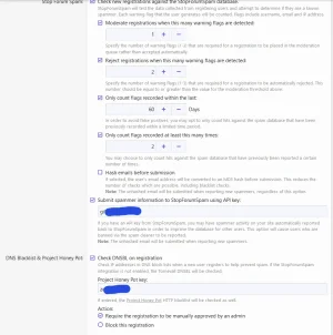

Here is what my settings are, I incorrectly assumed that unchecking "Moderate registrations when this many warning flags are detected" would do it.

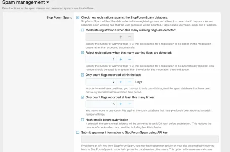

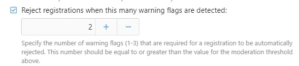

I believe it works in conjunction with the mod threshold so you need both e.g
2 for mod and 3 for reject means if there are 2 they go onto mod queue for assessment but 3 get rejected.
I think if both are 1 then any SFS flag is triggered so all are rejected, no mod queue. But beware this will include usernames registered with SFS, and a lot of usernames are also bonafide account registrations.

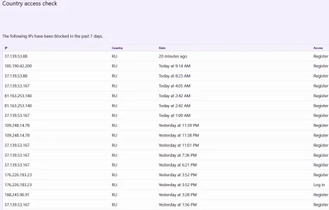

These work very well for me. It blocks all but a couple per month, EXCEPT common names. Those still appear in the mod queue, and most are legit mistakes. Donald, Rob, Mike, etc. I'm also using an XF2 Andy tool to block Russia and a couple other countries completely.
stopforumspam and project honeypot work well, to catch most of them. The keys are free.

are they all from Russia? One solution is to block that country. :)
We also get a lot of bots from COLOCROSSING and HETZNER servers, and blocked both of those.
