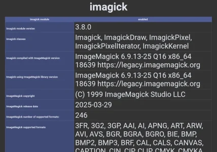

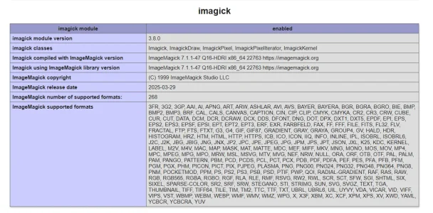

Using remi repos I do have the pecl extension:
php-pecl-imagick-im7-3.8.0-1.el9.remi.8.3.x86_64
And I verfied phpinfo looks similar:
I've been using the Imagemagick PECL extension for years. Just yesterday I ran into an issue updating to the latest ImageMagick 7 version so thought it best to post here in case anyone else may run into similar.
