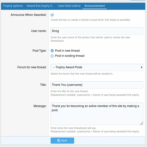

Announce When Trophy is Awarded
Announce When Trophy is Awarded 2.0.0.1

have this setup but it doesn't work anymore
It's still working for me. The last trophy I have configured to post a thread was Wednesday...
https://snogssite.com/forums/trophy-award-posts.28/
Are there any errors? Have you installed any new add-ons that might be conflicting with this one? Do you have the trophy set to post a new thread or post in an existing thread?
EDIT: I've tested both post in new thread and post in existing thread and they both work without a problem.
