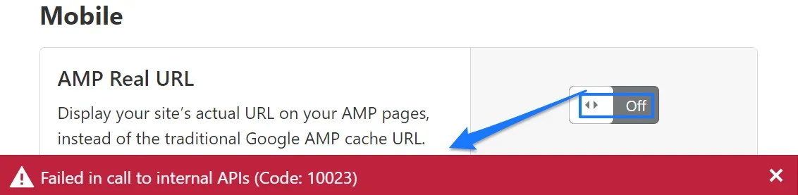

FYI for anyone trying to enable the cloudflare real URL they have had issues for the last week to fix it - https://community.cloudflare.com/t/amp-error-while-trying-to-enable-it/242627 But it seems that only affects the bounce rate so not too important.
