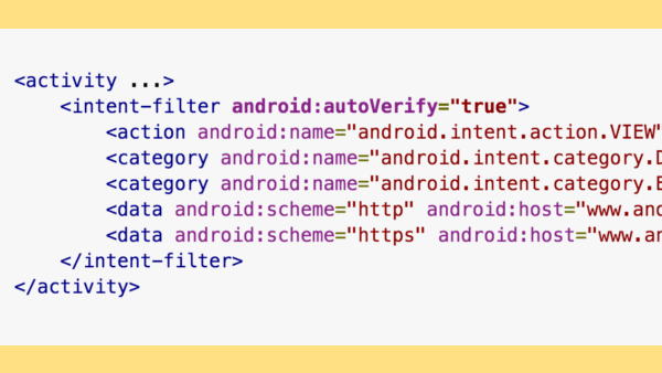

I see, it looks like the problem is I was using the deeplink of the app, in which I'll have implement this applink complexity to get around that. Whenever docs get created for this, it would be really helpful to add a note that the only supported schemes are http/https.
