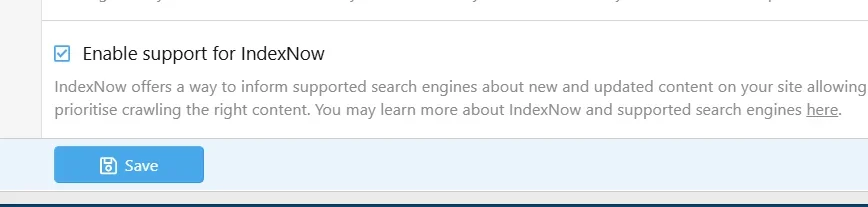

The fix comment refers to a potential case where a job to ping IndexNow about specific content could be queued up but the IndexNow option in the admin panel was disabled. In this case, there's no API key that can be used so the job would fail with the error in the original bug report.
To be clear, you don't need manually do anything other than just enabling the option. This will generate an API key behind the scenes and do the necessary work to expose it to IndexNow when making requests.
