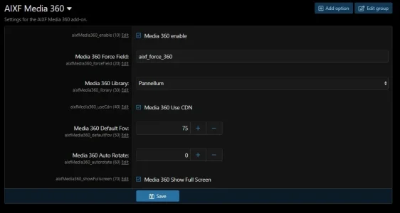

- Place local Pannellum files in the add-on (these are included if you used the “local” build):
- In ACP → Options → AIXF Media360 (if you exposed an option), set Use CDN = Off.
If you didn’t add an ACP option, set
data-cdn="0"
in the mount (see “How it works”).---

<div id="aixfPanoMount" class="js-aixf360"
data-enabled="1"
data-cdn="1" <!-- 1 = CDN (default), 0 = local -->
data-fov="75" <!-- initial zoom (HFOV) -->
data-autorotate="1.2" <!-- deg/sec; 0 = off -->
data-fullscreen="1" <!-- show fullscreen button -->
data-ratio-tolerance="0.05" <!-- 2:1 detection tolerance -->
style="width:100%;height:60vh"></div>
