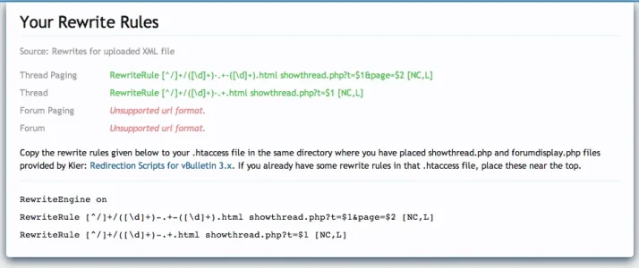

Hey Shadab.
I just upped my vBSEO xml to your excellent tool (thank you, by the way) but unfortunately it seems I have fallen at the first hurdle...see attached pic.Screen shot 2011-03-14 at 22.01.47.webp
I didn't think that we had ever customized our structure but there is definitely something "non-standard" in there. Sorting out the re-writes for our board is one of the crucial parts of a move to xF.
Is it as bad as it looks?
Here's the xml...
No. Like I said, as long as thread urls are redirected, there's no reason to worry.
In fact, there are 2 presets (#001 and #003) for which 'forum' url redirects cannot be generated. And unfortunately, the #001 preset is set to default when you install vbseo. Or at least that was the case when I installed it in 2007(?).
