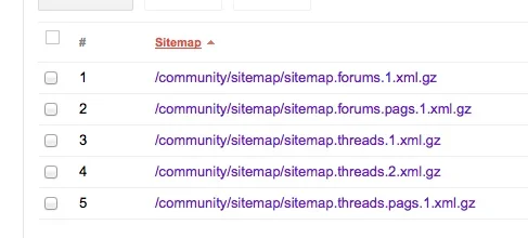

I believe it's part of the files you upload that cam with the add on zip file, is there a folder called "sitemap" in the upload folder?
There is 5 of them. sphynxlair.com is the site.

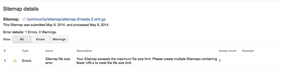

Ok, so I verified that the sitemap only contains 10,000 urls, so so far so fine.
Then, the size of the sitemap after zip is 167 Kb, and unzipped it is 1.4Mb

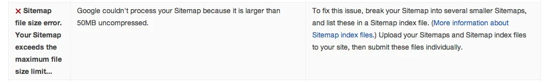

Which is weird, because the max official size is 10Mb, and actually google updated that limit to 50Mb, and you are under that limit.
https://support.google.com/webmasters/answer/35738?hl=en
I would try resubmitting it. You might want to go to options in the Admin Control Panel and change the urls per sitemap to a lower number (5000) if it is still failing
