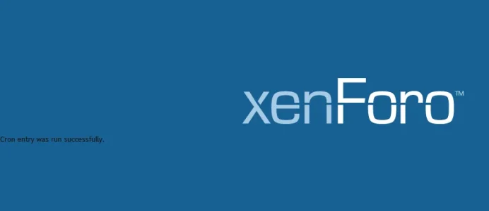

hi im kinda new to this i have a question what should i do after cron successfully run? should i submit sitemap/sitemap.xml.gz to the webmaster tools?
