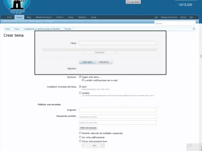

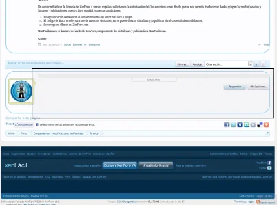

The addon works perfectly but if I keep it turned disappear the editor so I can not respond or create topics.
Have you been to one? Is this an error? Any solution other than disabling the add-on?

For some reason, when I enable XF Optimise I cannot see the reply box, and I cannot open the smilies tab (the happy place) ... it seems like some of the things are not working on the site.
Just wondering how to fix this... I have currently disabled XF Optimise, and will wait to see if I can get an answer to this and hopefully solve it.
