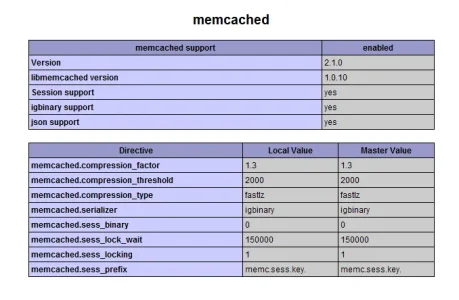

Yes, on CentOS 5 you need gcc44. Congrats. You could also install instead the Axivo rpm's?
You are done... not to mention that you get JSON and Igbinary support, as well PHP sessions cached directly into Memcached server.
View attachment 32650 View attachment 32651
Ya, pretty sure they have a deb package... maybe not the latest version but they do have something.Can you use libmemcached with Debian lenny?
Nope, done both servers as wellYou don't waste time ehh? Bravo.![]()

Yes, you can enable both of them. In my rpm's the common params are commented by default so the value falls into standard PHP settings (session.save_handler and session.save_path). Not sure how Memcached will react if you run both memcached and libmemcached in parallel while using the same IP/port, is been a long time I stopped using the deprecated memcache library. You can assign a different port to prevent any possible conflicts.Not sure if they can be run in parallel though?

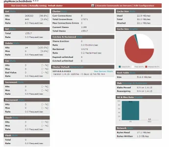

Can you make me a favor and check the memcached stats? Let me know how is your waste, mines is HUGE on 1.1.14 with slab_reassign and slab_automove enabled. Deebs is gone missing in action, heh. See my previous post, related to this matter.Thanks for the heads up on installing these...

Start memcached with -o slab_reassign,slab_automove and let me know if the waste is lower... your is double than mines, LOL.
Thanks, have changed my config file:Start memcached with -o slab_reassign,slab_automove and let me know if the waste is lower... your is double than mines, LOL.

	You are missing a comma? -o slab_reassign,slab_automove NOT -o slab_reassign slab_automoveCode:nobody 18265 1 0 08:46 pts/0 00:00:00 /usr/local/bin/memcached -u root -m 32 -p 11211 -u nobody -l 127.0.0.1 -o slab_reassign slab_automove
/usr/bin/memcached -d -l 127.0.0.1 -p 11211 -U 11211 -u memcached -P /var/run/memcached/memcached.pid -t 4 -m 64 -c 1024 -n 48 -f 1.25 -o slab_reassign slab_automove
I too have a lot of wasted space and also a large amount of free memory, to be honest I am not worrying about it. What I will do is telnet to the daemon and check the stats incase it is the GUI app getting confused.Same here. How is your waste on the server? Even if I have the slabs set to auto recycle, I get a high waste:
It does not makes sense to me, is the waste managed when the max memory threshold hits? So far there is about 50% of allocated memory marked as free so maybe that why the slabs are sitting there...
