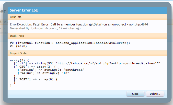

I can reliably cause an error with the following route:
In addition, the getnodes action is public by default, and will show all nodes on the forum, regardless of permissions. This means that my "super secret board here is the password to whatever" description is visible to literally anyone who knows we have this API installed (e.g. anyone who read the announcement thread).

Thanks for that error, could add an issue on the issue tracker so I can track it?
I will take a look regarding getNodes, I know I worked on something regarding view permissions regarding threads and posts. I might be able to do the same for getNodes. Could you add an issue for that as well? Thanks!
