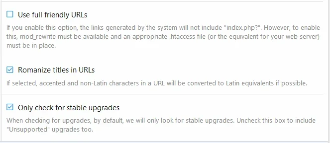

I have a basic question about this option, because i really hate the "index.php?" showing everywhere and i was looking to disable this thing, checking the "Use full friendly URLs" on XF Options.
But in the description there is a scary warning:
I don't know what is a .htaccess file and i don't know how to configure, and don't know the implications if I'm check this option.

If you open the Admin Control Panel home page (icon of a home in the top left of the admin control panel), scroll down the right hand side of the page - what does it say next to Server Software? If it says somewhere in there "Apache", then you are likely good to go with full friendly URLs. You would just need to check with your server host if mod_rewrite is enabled (it needs to be for .htaccess to work).
.htaccess file only tells server how to (re)format URL requests. It won't affect any data you have in your database and the .htaccess rules don't affect the admin control panel, so you won't lose access to the forum or any data.

Thanks for the replies guys. I did read the Manual Brogan, but my skills are a little limited in server configurations, that's why i came here.
My software is "Nginx", and, considering the info on the manual i have to put this code somewhere inside my server configuration:
location /xf/ {
    try_files $uri $uri/ /xf/index.php?$uri&$args;
    index index.php index.html;
location /xf/install/data/ {
    internal;
location /xf/install/templates/ {
    internal;
location /xf/internal_data/ {
    internal;
location /xf/library/ { #legacy
    internal;
location /xf/src/ {
    internal;
location ~ \.php$ {
    try_files $uri =404;
    fastcgi_pass    127.0.0.1:9000;
    fastcgi_param   SCRIPT_FILENAME $document_root$fastcgi_script_name;
    include         fastcgi_params;
I did notice that i have to change the "/xf" patch, but what exactly i have to do?
My Forum is installed in the following subdomain: forum.politz.com.br or "my_forum_link/public_html".
if your forum is in the /public_html/ and not in a sub directory then you do need to edit your domain nginx config file and add the code you mentioned, but you must replace "/xf/" with "/"
