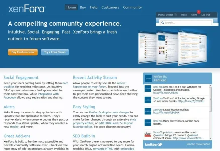

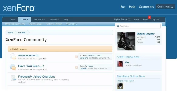

I would be very excited to see Xenforo enable the platform such that average webmasters could accomplish this:
I'm confused... Those mock-ups showed absolutely nothing and were a hack job. The second one can be accomplished via template edits... The first can also be completed. However, if you want them to release the front page code, I'd think again.
