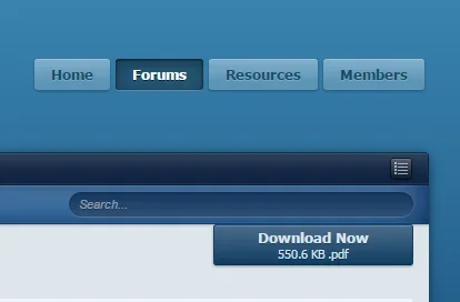

Now, after a week color tweeking this super awesome Velour, all I need is the top nav buttons to function in a more usual way.
From the index page loaded, the top navigation buttons become deactivated if I first click on one of 'New Posts' 'Watched Threads' or 'Watched Forums'. (Could it be that this feature is some kind of development mode that slipped through...?)
Tested with XF 1.5.9 without add-ons enabled. However, I also did test with XF Media Gallery enabled. The extra (XFMG) nav button becomes deactivated amongst the others.

Right now I can't see that the issue is XF version related. I get pretty much the same result on 1.5.9, 1.5.8 and 1.5.7. But it does relate to Height of Header Logo (Style Properties: Header and Navigation). It also seems to be related to whether or not one is logged in – but I haven't looked into that so it's left out here.
I'm not very familiar with CSS but it's like there is an invisible layer that may cover the buttons and can make them inoperable for mouse inputs. Also, it's affeted by the Height of Header Logo setting. If set on the high side, buttons become covered only partly. If set to around 275px or more the problem actually disappears. But then you have a huge empty space on the page.
On my page I use only 70px (Height of Header Logo) and the *button cover layer* affects the buttons entirely (See attached "video fully_covered_mp4.zip")

I think it's solved.
Buttons now do work as expected also after clicking 'New Posts' 'Watched Threads' and 'Watched Forums'.
I did:
Style Properties / Header and Navigation / Navigation Tab / Miscellaneous: z-index: 2;
