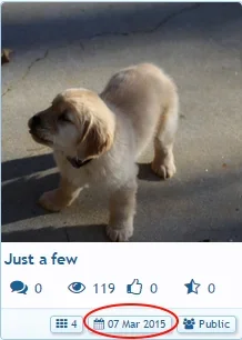

What date is being displayed?
"XX Oct 2014", which is the day when I performed the migration. XX is a number of two digits.
And where is it being displayed?
At community/media/albums and when viewing the albums tab at members/someone.123. In fact, in every place where there is the following:
Also when viewing the album itself at the "Last Update" line inside the "Information" block.
