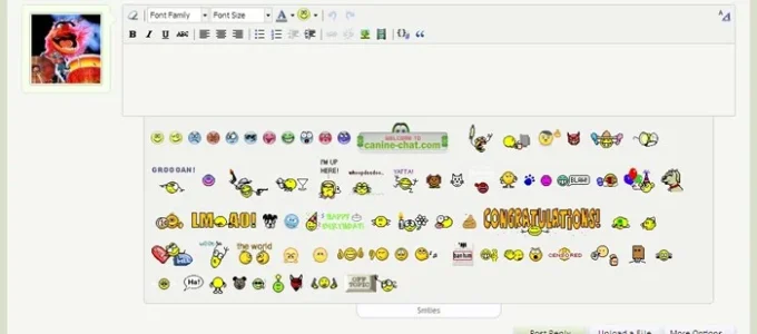

What it actually does is open the dropdown on the main editor window but the overlay mask only allows the smilies which aren't covered by it to be selected.
Not sure how easy a fix it's going to be to get that working...

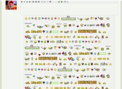

If i try to open the dropdown from the overlay and finish editing my post then try to open the smilie dropdown from the Quick Reply i get my smilies doubled and tripled..
Just Reporting my findings on Beta6
Edit: at least we can see what it looks with with tons of different sizes and shapes even if they are just repeating.
Edit: Refreshing the page seems to bring things back around.
You will get a new set of smilies being displayed in the quick reply area every time you open the pop-up editor for a different post. Load a thread with three posts, open each of them in the pop-up editor, then look at the smilies area under the quick reply box. You'll see four sets of smilies.
The reason for this is that happyplace uses unique IDs to identify elements in its templates, which means that when there are multiple editors open, the Javascript doesn't know which element to talk to.
The solution is to add a unique identifier to each ID so that each editor instance is different. Take a look at the editor template in XenForo and you'll see that ID fields are made unique using the {$editorId} variable, which is different per editor. The happyplace should be able to implement the same thing to fix the problem.
